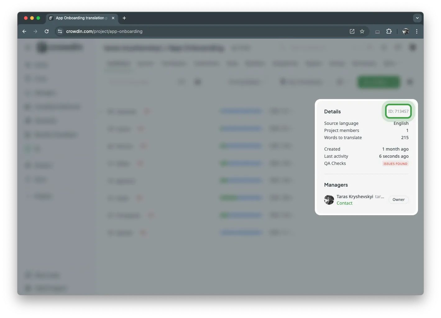

Create Translation Project
The Crowdin project is just like a Git repo but for translation files. To create one, visit this page. Once you have completed this step, you should find a Crowdin project ID and save it.
screenshot of the project page with the project id highlighted
